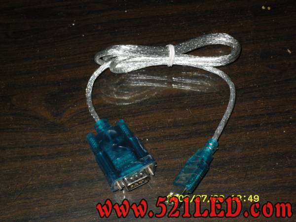

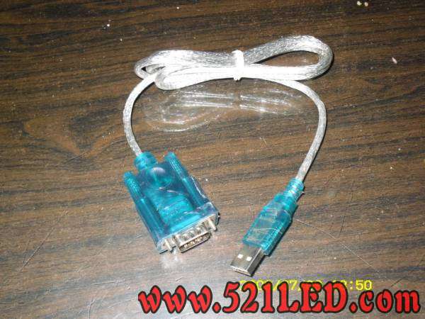

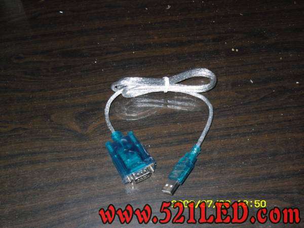

xusuwu 发表于 2009-7-18 07:38:12 | 显示全部楼层
[whitepad]***400;200;400,200;;** m66,48 l82,48,87,49,95,50,101,51,108,52,111,53,114,55,116,55,116,62,112,62 e|********* m57,71 l67,71,70,72,76,72,79,73,83,74,86,74,91,75,95,75,98,76,102,76 e|********* m79,76 l78,76,77,77,77,78,76,80,75,80,72,83,71,85,69,87,68,89,68,90,67,90,67,91,66,92,66,93,65,94,65,96,69,96,81,98,89,99,97,101 105,102,112,102,117,103,126,103,128,105,128,109,129,112,129,174,127,178,125,181,123,185,121,187,116,187,115,185,111,183,102,174,96,167,89,160,82,150 e|********* m168,44 l168,59,169,64,169,72,170,75,170,79 e|********* m194,53 l209,53,209,66,207,66,205,68,201,70,198,71,197,72,173,72 e|********* m164,95 l164,102,165,105,165,109,166,112,167,116,167,123,168,121,174,115,177,114,179,113,180,112,184,110,200,110,202,112,202,114,203,114,204,115,205,117,206,118,206,139 205,140,184,140,183,139,181,139,181,138,180,137,179,137,179,136,178,135,177,133,174,130,174,127,173,126,172,126,172,125,170,123,170,120 e|********* m190,101 l190,121,189,123,189,125,188,127,188,134,187,135,187,139,186,140,186,147,185,147,185,152,184,152 e|********* m152,163 l152,162,153,161,155,160,157,160,161,158,164,157,167,157,170,155,239,155 e|********* m239,138 l239,151,240,156,241,162,242,166,243,169,245,174,246,177,248,181,248,183 e[/whitepad]
无影剑 发表于 2009-7-18 20:51:11 | 显示全部楼层
8楼的你的转接线能用吗?能用的话说一下你的用法好吗?我有一个和你一样的线不能用,后来换了一根贵一点的就OK了。
七彩光电 发表于 2009-7-19 17:35:47 | 显示全部楼层
我来补充吧,这个我最有发言权了!我也是用的笔记本(同样没有串口)。控制卡的通讯连接我这里补充几句。有些控制卡的通讯连接是235直接连的。有些控制卡的通讯需要调换23交叉相连!!再有就是通讯速率的问题,这个是重点!!有些便宜的转换线速度低,版本差,总出现通讯问题,要重新插拔,反复多次才能完成发送!只有小型的控制卡才能用他成功发送。稍大点的卡就没法用了!开始的时候我用了一条30元的转接线,连接坛主的多功能控制卡,每次发送超文本就中途中断连接!为此我找过坛主多次,嘻嘻。其实问题不在卡上。这里给坛主赔个不是,抱歉!问题就在线上!。。。。。不说我的经历了。说结果!强力推荐大家用高速通讯的(力特USB2.0)一定要买带防伪的《力特》不是便宜的《帝特》!要买2.0的 2.0的速度快过1.0的!用这条线连接刻字机 打印机都没问题!我用视展,仰邦的卡都没问题!
