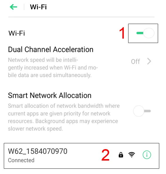

02Wi-Fi connection
Turnoff the mobiledata/ Bluetooth of the phone, turn on the WLAN in thephone setting, and connect to card’s Wi-Fi.

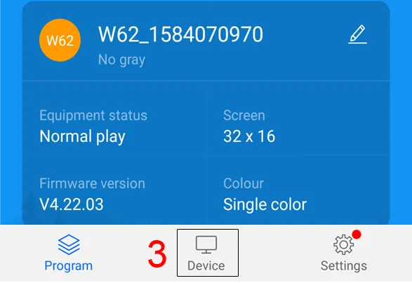

Check if the device is online
Asshown, click "Device", you can see the device informationindicating that the device is online.

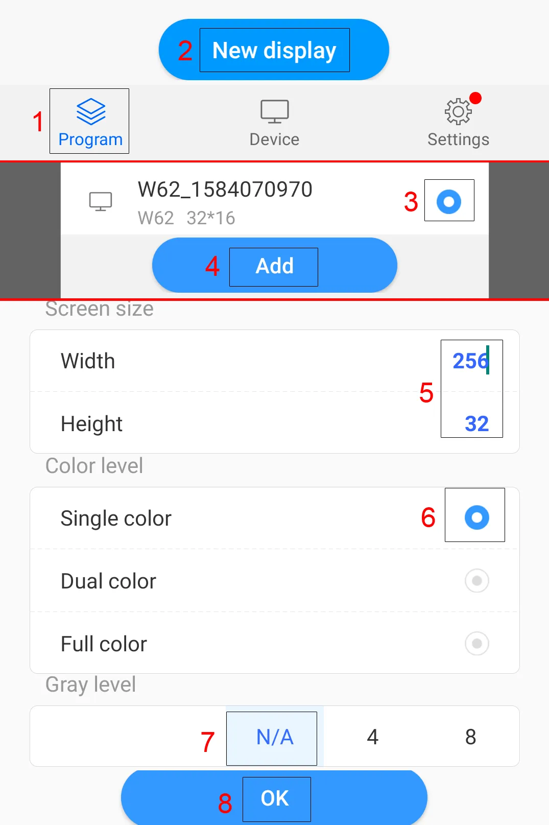

04Create new screen (program)

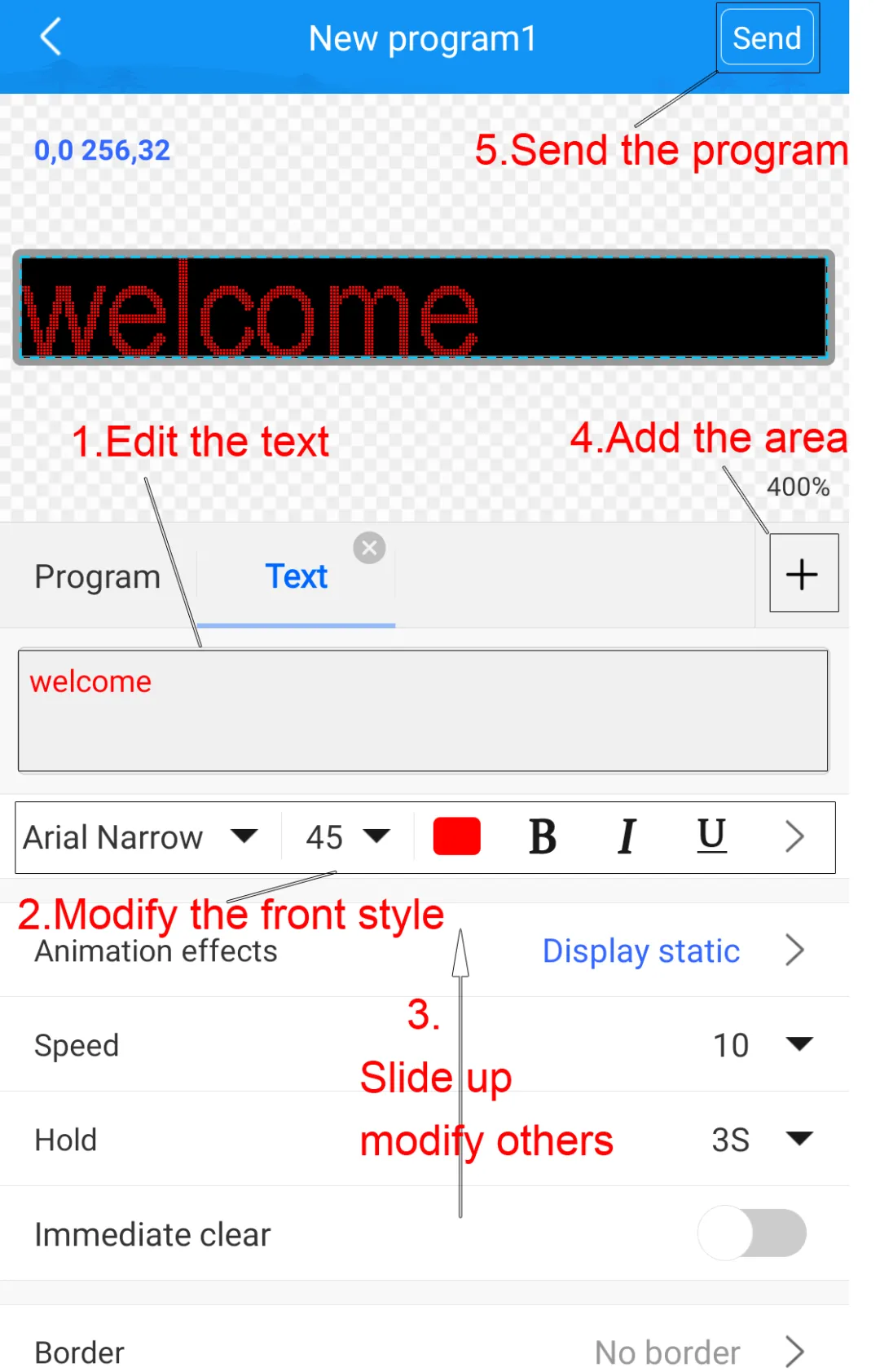

Clickthe “program”→“new display”→select the device→“add”→setthe width and height of screen→select the color→select the graylevel→“OK”
05Edit and send the program

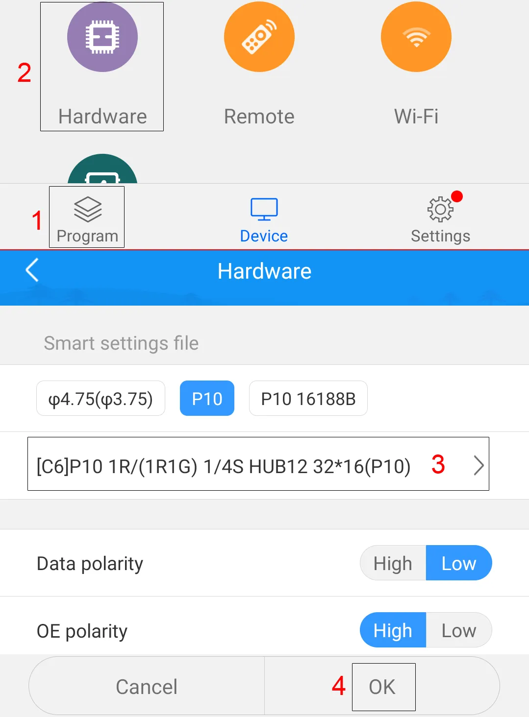

06Hardware setting
Click“Device”→“Hardwaresetting”,password is 888→select the configuration file→“OK”

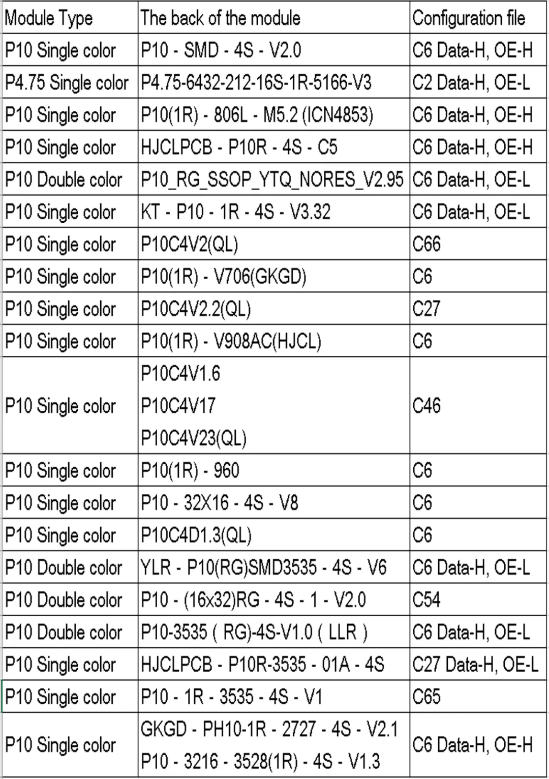

The third step, if do not know which scan need to choose,pleasecheck the list of Configuration file of module.
Data-H is the Data polarity is high and L is low, OE-L is the OE polarity islow and H is high.
Note:
1) If black text on a red background, the data polarity is set inreverse;
2) If the text is dark, the OE polarity is set inreverse;
3) If the configuration file don’t work, please do smart setting.

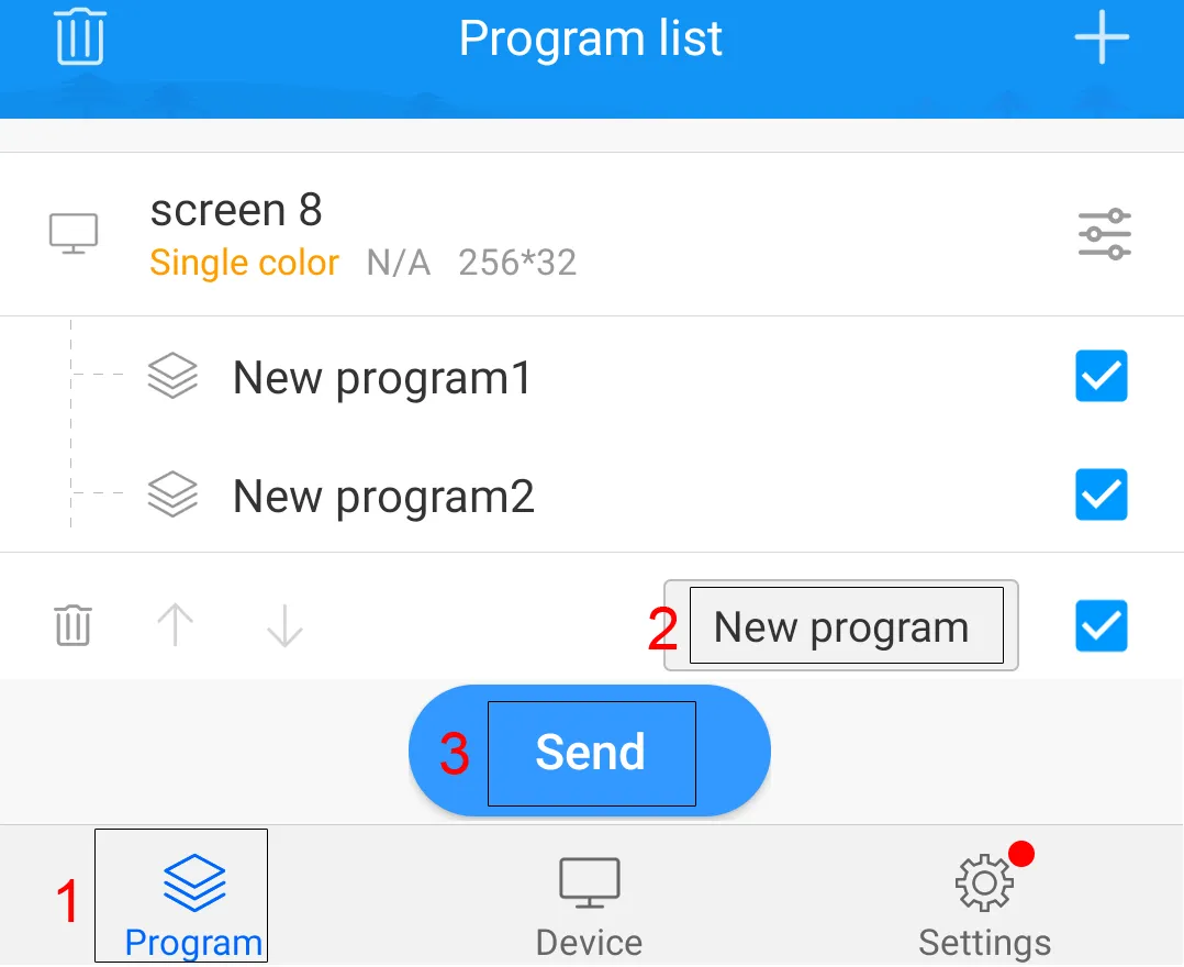

Q1:How to add multiple programs?
Exitprogram editing, return to the program list, add multiple programs,and edit the programs before sending them together.

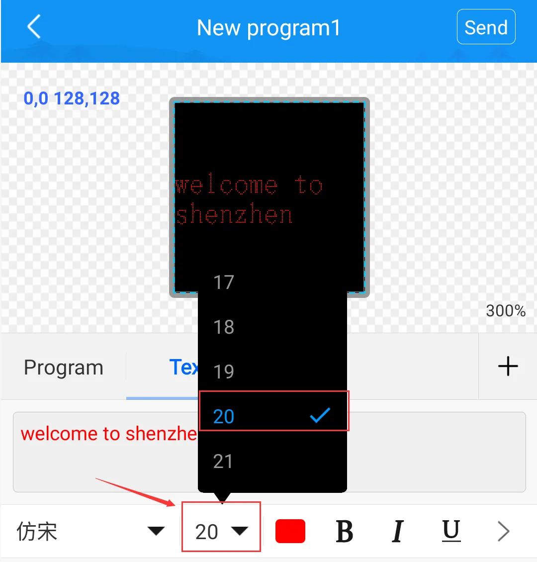

Q3:How to set the text to be displayed onmultiple lines?
Bydefault, the text will be automatically adjusted following the textarea. Only need to modify it to a fixed fontsize to display multiple lines.

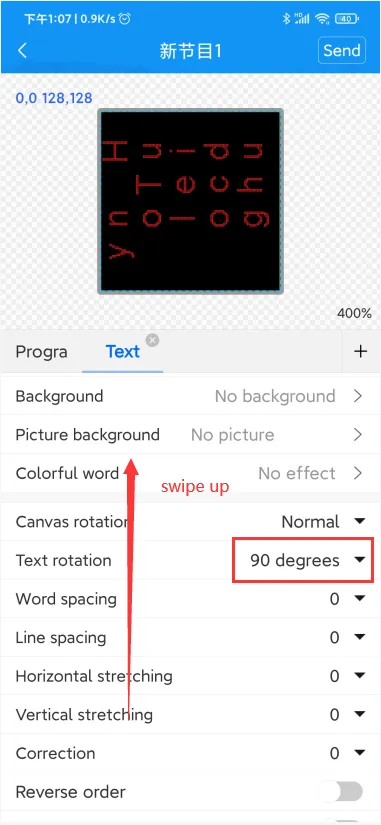

Q4:How to set text rotation?
Inthe lower part of software, press and swipe up to find "Textrotation" setting. Then choose the rotation degrees you want.

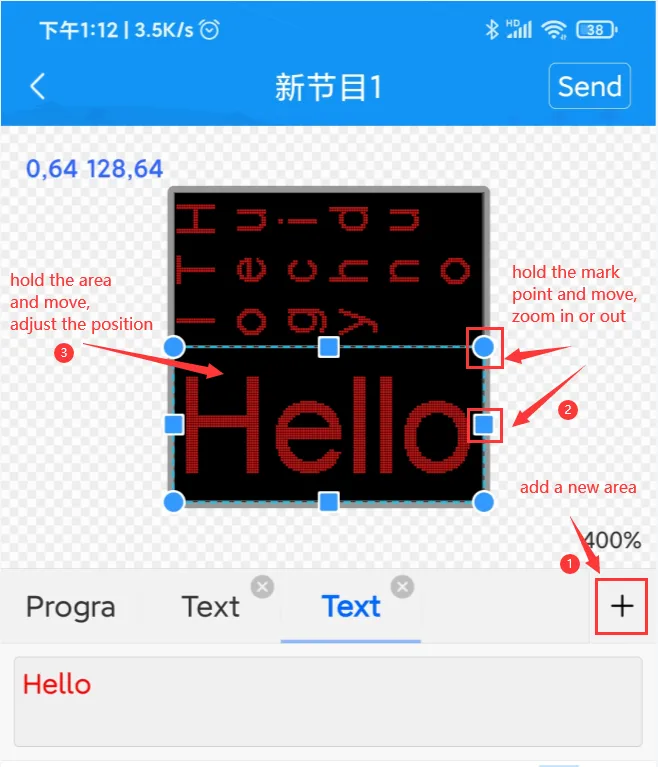

Q5:How to set partition display?
Click "+" to add a new text area, and hold the blue mark dots "图片"and "图片"in the analog display area. Then drag it to zoom in or out the area.Hold the area and move to adjust it's position.

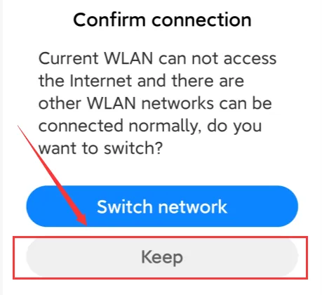

Q6:When Wi-Fi connected but no device online, howto do?
  1. Turn off mobile data, Bluetooth, VPN and so on;
  2. When Wi-Fi is connected and there is a message from your phone: Current WLAN cannot access the Internet and there are other WLAN networks can be connected normally, do you want to switch? Choose "Keep".
